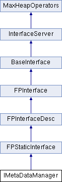

The interface for creating, adding, removing and keeping track of meta-data on max Animatables.
Meta-data are custom attributes that contain only a parameter block. In order to create meta-data, you have to create its definition by specify the parameters first. This will give you a meta-data ID. You can then use that ID to add, remove or list meta-data in the scene.
