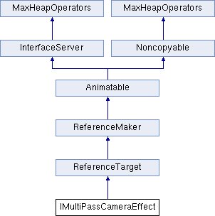

 Inheritance diagram for IMultiPassCameraEffect:
 Inheritance diagram for IMultiPassCameraEffect:| Public Member Functions | |
