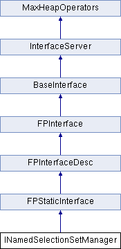

INamedSelectionSetManager Class Reference
#include <INamedSelectionSetManager.h>
Class Description
The Named Selection Sets management class.
The user may use functions exposed by this class to manage all the named selection sets of objects.
Note
This class DOES NOT deal with named selection sets of sub-objects but only named selection sets of objects.
+ Inheritance diagram for INamedSelectionSetManager:
