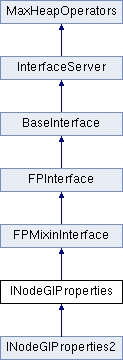

class INodeGIProperties : public FPMixinInterface
- Description:
- This class is only available in release 5 or later.
 This class defines an interface for accessing a node's global illumination properties.
 An instance of this interface can be retrieved using the following line of code (assuming 'node' is of type INode*):
 static_cast<INodeGIProperties*>(node->GetInterface(NODEGIPROPERTIES_INTERFACE))
 Geometric and object objects have different properties. Accessing/setting geometric properties of non-geometric objects is safe, but will have no effect in the global illumination solution.
 Here is a description of the global illumination properties:
