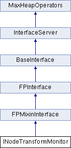

+ Inheritance diagram for INodeTransformMonitor:
