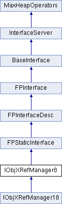

+ Inheritance diagram for IObjXRefManager8:
