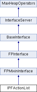

| FPInterfaceDesc * | GetDesc () |
| | Must implement GetDescByID method. More...
| virtual int | NumActions () const =0 |
| virtual INode * | GetAction (int index) const =0 |
| virtual bool | AppendAction (INode *action)=0 |
| virtual bool | InsertAction (INode *action, int indexAt)=0 |
| virtual bool | RemoveAction (int index)=0 |
| virtual bool | HasAction (INode *action, int &index) const =0 |
| virtual bool | IsActivated () const =0 |
| virtual void | Activate (bool active)=0 |
| | Activate/deactivate all the actions in the list. More...
| virtual int | IsActionActive (int index) const =0 |
| virtual void | ActivateAction (int index, int active=1)=0 |
| virtual void | GetPViewLocation (int &x, int &y)=0 |
| virtual void | SetPViewLocation (int x, int y) |
| virtual int | GetPViewZOrder () |
| virtual void | SetPViewZOrder (int z) |
| virtual int | GetListWidth () |
| virtual void | SetListWidth (int w) |
| PFExport int | GetPViewRightBoundary () |
| | Returns x-coord of the right side of the action list. More...
| virtual bool | IsCollapsed () |
| | Action list may be shown in a "collapsed" state in ParticleView. More...
| virtual void | Collapse () |
| virtual void | Expand () |
| virtual bool | HasUpStream () |
| | Indicates if there are PFSystems or ActionLists that direct particle flow in this action list. More...
| virtual int | GetSelected () const |
| | ActionList has its own methods for selecting. More...
| virtual void | SetSelected (int onOff) |
| | See virtual int GetSelected(). More...
| virtual bool | AcceptFertile () |
| | ActionList has some restrictions on whether it is able to add a "fertile" action. More...
| virtual void | UpdateMaterial () |
| | The method is used to initiate material update in the associated particle group. More...
