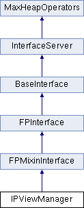

+ Inheritance diagram for IPViewManager:
