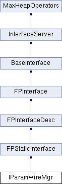

+ Inheritance diagram for IParamWireMgr:
