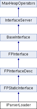

A core interface used to store parser DLLs found in the system.
| virtual int | GetNumberOfParsers ()=0 |
|  | The total number of parsers found at startup.  More...
| virtual IEffectParser * | GetParser (ULONG parserID)=0 |
|  | Get a parser based on parser ID.  More...
| virtual void | LoadDLLs ()=0 |
|  | used by the system to load the parser DLLs from disk  More...
| virtual void | UnloadDLLs ()=0 |
|  | Used by the system to unload the DLLs.  More...
| virtual const MCHAR * | GetParserFilter (int index)=0 |
|  | Get the filter name. THis will be used in the open dialog boxes.  More...
| virtual const MCHAR * | GetParserExtension (int index)=0 |
|  | Get the file extension for the parser. THis will be used in the open dialog boxes.  More...
| CoreExport | FPInterfaceDesc () |
| CoreExport | FPInterfaceDesc (Interface_ID id, const MCHAR *int_name, StringResID descr, ClassDesc *cd, ULONG flag,...) |
| CoreExport | ~FPInterfaceDesc () |
| virtual void | Init () |
| LifetimeType | LifetimeControl () |
| virtual BaseInterface * | GetInterface (Interface_ID id) |
| CoreExport void | LoadDescriptor (Interface_ID id, const MCHAR *int_name, StringResID descr, ClassDesc *pCD, ULONG flag,...) |
| CoreExport void | AppendFunction (int id,...) |
|  | Add a new function to this interface descriptor.  More...
| CoreExport void | AppendProperty (int id,...) |
|  | Add a new property to this interface descriptor.  More...
| CoreExport void | AppendEnum (int id,...) |
|  | Add a new enum to this interface descriptor.  More...
| CoreExport void | SetClassDesc (ClassDesc *i_cd) |
| CoreExport va_list | check_fn (va_list ap, int id) |
| CoreExport va_list | scan_fn (va_list ap, int id, int index) |
| CoreExport va_list | check_prop (va_list ap, int id) |
| CoreExport va_list | scan_prop (va_list ap, int id, int index) |
| CoreExport va_list | check_enum (va_list ap, EnumID id) |
| CoreExport va_list | scan_enum (va_list ap, EnumID id, int index) |
| FPInterfaceDesc * | GetDesc () |
| Interface_ID | GetID () |
| CoreExport FPFunctionDef * | GetFnDef (FunctionID fid) |
| ActionTable * | GetActionTable () |
| CoreExport void | EnableActions (BOOL onOff) |
| virtual CoreExport HINSTANCE | HInstance () |
| virtual CoreExport const MCHAR * | GetRsrcString (StringResID id) |
| virtual CoreExport FPStatus | Invoke (FunctionID fid, TimeValue t=0, FPParams *params=NULL) |
| virtual FPStatus | Invoke (FunctionID fid, FPParams *params) |
| virtual CoreExport FPStatus | Invoke (FunctionID fid, TimeValue t, FPValue &result, FPParams *params=NULL) |
| virtual FPStatus | Invoke (FunctionID fid, FPValue &result, FPParams *params=NULL) |
| virtual CoreExport FunctionID | FindFn (const MCHAR *name) |
| virtual CoreExport BOOL | IsEnabled (FunctionID actionID) |
| virtual CoreExport BOOL | IsChecked (FunctionID actionID) |
| virtual CoreExport BOOL | IsVisible (FunctionID actionID) |
| virtual CoreExport FunctionID | GetIsEnabled (FunctionID actionID) |
| virtual CoreExport FunctionID | GetIsChecked (FunctionID actionID) |
| virtual CoreExport FunctionID | GetIsVisible (FunctionID actionID) |
| virtual UtilExport | ~BaseInterface () |
|  | Destructor.  More...
| virtual bool | RegisterNotifyCallback (InterfaceNotifyCallback *incb) |
| virtual void | UnRegisterNotifyCallback (InterfaceNotifyCallback *incb) |
| virtual BaseInterface * | AcquireInterface () |
| virtual void | ReleaseInterface () |
| virtual void | DeleteInterface () |
| virtual BaseInterface * | CloneInterface (void *remapDir=NULL) |
| virtual UtilExport | ~InterfaceServer () |
|  | Destructor.  More...
| enum | LifetimeType { noRelease,
immediateRelease,
wantsRelease,
serverControlled
| static UtilExport void * | operator new (size_t size) |
|  | Standard new operator used to allocate objects If there is insufficient memory, an exception will be thrown.  More...
| static UtilExport void * | operator new (size_t size, const std::nothrow_t &e) |
|  | Standard new operator used to allocate objects if there is insufficient memory, NULL will be returned.  More...
| static UtilExport void * | operator new (size_t size, const char *filename, int line) |
|  | New operator used to allocate objects that takes the filename and line number where the new was called If there is insufficient memory, an exception will be thrown.  More...
| static UtilExport void * | operator new (size_t size, int block_type, const char *filename, int line) |
|  | New operator used to allocate objects that takes the type of memory, filename and line number where the new was called If there is insufficient memory, an exception will be thrown.  More...
| static UtilExport void * | operator new (size_t size, const std::nothrow_t &e, const char *filename, int line) |
|  | New operator used to allocate objects that takes the filename and line number where the new was called If there is insufficient memory, NULL will be returned.  More...
| static UtilExport void * | operator new (size_t size, unsigned long flags) |
|  | New operator used to allocate objects that takes extra flags to specify special operations If there is insufficient memory, an exception will be thrown.  More...
| static UtilExport void * | operator new (size_t size, const std::nothrow_t &e, unsigned long flags) |
|  | New operator used to allocate objects that takes extra flags to specify special operations If there is insufficient memory, NULL will be returned.  More...
| static UtilExport void * | operator new[] (size_t size) |
|  | New operator used to allocate arrays of objects If there is insufficient memory, an exception will be thrown.  More...
| static UtilExport void * | operator new[] (size_t size, const std::nothrow_t &e) |
|  | New operator used to allocate arrays of objects If there is insufficient memory, NULL will be returned.  More...
| static UtilExport void * | operator new[] (size_t size, const char *filename, int line) |
| static UtilExport void * | operator new[] (size_t size, int block_type, const char *filename, int line) |
|  | New operator used to allocate arrays of objects.  More...
| static UtilExport void * | operator new[] (size_t size, const std::nothrow_t &e, const char *filename, int line) |
| static UtilExport void * | operator new[] (size_t size, unsigned long flags) |
| static UtilExport void * | operator new[] (size_t size, const std::nothrow_t &e, unsigned long flags) |
| static UtilExport void | operator delete (void *ptr) |
|  | Standard delete operator used to deallocate an object If the pointer is invalid, an exception will be thrown.  More...
| static UtilExport void | operator delete (void *ptr, const std::nothrow_t &e) |
|  | Standard delete operator used to deallocate an object If the pointer is invalid, nothing will happen.  More...
| static UtilExport void | operator delete (void *ptr, const char *filename, int line) |
|  | Delete operator used to deallocate an object that takes the filename and line number where the delete was called If the pointer is invalid, an exception will be thrown.  More...
| static UtilExport void | operator delete (void *ptr, int block_type, const char *filename, int line) |
|  | Delete operator used to deallocate an object that takes the type of memory, filename and line number where the delete was called If the pointer is invalid, an exception will be thrown.  More...
| static UtilExport void | operator delete (void *ptr, const std::nothrow_t &e, const char *filename, int line) |
|  | Delete operator used to deallocate an object that takes the filename and line number where the delete was called If the pointer is invalid, nothing will happen.  More...
| static UtilExport void | operator delete (void *ptr, unsigned long flags) |
|  | Delete operator used to deallocate an object that takes extra flags to specify special operations If the pointer is invalid, an exception will be thrown.  More...
| static UtilExport void | operator delete (void *ptr, const std::nothrow_t &e, unsigned long flags) |
|  | Delete operator used to deallocate an object that takes extra flags to specify special operations If the pointer is invalid, nothing will happen.  More...
| static UtilExport void | operator delete[] (void *ptr) |
|  | Standard delete operator used to deallocate an array of objects If the pointer is invalid, an exception will be thrown.  More...
| static UtilExport void | operator delete[] (void *ptr, const std::nothrow_t &e) |
|  | Standard delete operator used to deallocate an array of objects If the pointer is invalid, nothing will happen.  More...
| static UtilExport void | operator delete[] (void *ptr, const char *filename, int line) |
|  | Delete operator used to deallocate an array of objects that takes the filename and line number where the delete was called If the pointer is invalid, an exception will be thrown.  More...
| static UtilExport void | operator delete[] (void *ptr, int block_type, const char *filename, int line) |
|  | Delete operator used to deallocate an array of objects that takes the type of memory, filename and line number where the delete was called If the pointer is invalid, an exception will be thrown.  More...
| static UtilExport void | operator delete[] (void *ptr, const std::nothrow_t &e, const char *filename, int line) |
|  | Delete operator used to deallocate an array of objects that takes the filename and line number where the delete was called If the pointer is invalid, nothing will happen.  More...
| static UtilExport void | operator delete[] (void *ptr, unsigned long flags) |
|  | Delete operator used to deallocate an array of objects that takes extra flags to specify special operations If the pointer is invalid, an exception will be thrown.  More...
| static UtilExport void | operator delete[] (void *ptr, const std::nothrow_t &e, unsigned long flags) |
| static UtilExport void * | operator new (size_t size, void *placement_ptr) |
|  | Placement new operator.  More...
| static UtilExport void | operator delete (void *ptr, void *placement_ptr) |
|  | Placement delete operator.  More...
| static UtilExport void * | aligned_malloc (size_t size, size_t alignment) |
|  | Allocates memory on a specified alignment boundary.  More...
| static UtilExport void * | aligned_realloc (void *ptr, size_t size, size_t alignment) |
|  | Reallocates memory on a specified alignment boundary.  More...
| static UtilExport void | aligned_free (void *ptr) |
|  | Frees a block of memory that was allocated with aligned_malloc/aligned_realloc.  More...
| Interface_ID | ID |
| MSTR | internal_name |
| StringResID | description |
| ClassDesc * | cd |
| USHORT | flags |
| Tab< FPFunctionDef * > | functions |
| Tab< FPPropDef * > | props |
| Tab< FPEnum * > | enumerations |
| MSPluginClass * | pc |
| Rollout * | rollout |
| ActionTable * | action_table |
| static CoreExport FPInterfaceDesc | nullInterface |
| CoreExport void | load_descriptor (Interface_ID id, const MCHAR *int_name, StringResID descr, ClassDesc *cd, USHORT flag, va_list ap) |
| virtual FPStatus | _dispatch_fn (FunctionID fid, TimeValue t, FPValue &result, FPParams *p) |
