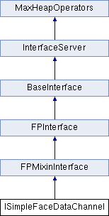

+ Inheritance diagram for ISimpleFaceDataChannel:
