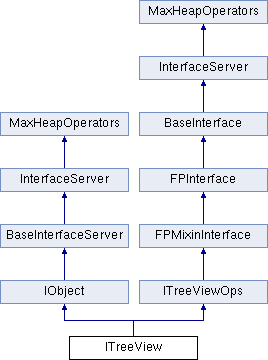

| virtual | ~ITreeView () |
| virtual void | SetPos (int x, int y, int w, int h)=0 |
| virtual void | Show ()=0 |
| virtual void | Hide ()=0 |
| virtual BOOL | IsVisible ()=0 |
| virtual BOOL | InViewPort ()=0 |
| virtual void | SetTreeRoot (ReferenceTarget *root, ReferenceTarget *client=NULL, int subNum=0)=0 |
| virtual void | SetLabelOnly (BOOL only)=0 |
| virtual void | SetMultiSel (BOOL on)=0 |
| virtual void | SetSelFilter (TrackViewFilter *f=NULL)=0 |
| virtual void | SetActive (BOOL active)=0 |
| virtual BOOL | IsActive ()=0 |
| virtual HWND | GetHWnd ()=0 |
| virtual int | GetTrackViewParent (int index)=0 |
| virtual void | Flush ()=0 |
| virtual void | UnFlush ()=0 |
| virtual void | SetMatBrowse ()=0 |
| virtual DWORD | GetTVID ()=0 |
| virtual const MCHAR * | GetIObjectName () |
| virtual int | NumInterfaces () |
| virtual BaseInterface * | GetInterfaceAt (int index) |
| virtual BaseInterface * | GetInterface (Interface_ID id) |
| virtual void | AcquireIObject () |
| virtual void | ReleaseIObject () |
| virtual void | DeleteIObject () |
| virtual UtilExport int | NumInterfaces () const |
| virtual UtilExport BaseInterface * | GetInterfaceAt (int i) const |
| virtual UtilExport | ~BaseInterfaceServer () |
| virtual UtilExport | ~InterfaceServer () |
|  | Destructor.  More...
