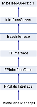

In 3ds Max 2013, 3ds Max introduces the tabbed view panels.
Previously 3ds Max can have only one view panel(One view panel contains at most 4 viewports). Now 3ds Max users can create additional view panels other than the default view panel by using the tabbed view panel toolbar or MaxScript. Users can switch between those view panels. At one time, there can only be one view panel visible which we usually call it current view panel or active view panel. Each view panel can have one active viewport. Users can also destroy those additional view panels (NOTE: The default view panel can't be destroyed). Tabbed view panels will be saved & loaded during FileIO. When saving as previous, only the current active view panel will be saved. This interface is used to manage the multiple tabbed view panels. To acquire this interface, simply use the codes below.
In a future release of 3ds Max we will introduce the notion of visible and floating view panels. When this is done, more than one view panel at a time can be visible. There will always be the main view panel attached to 3ds Max main window but you will be able to set visible, floating view panels, which could be put on another monitor. To support these visible view panels, instead of using GetActiveViewPanel() and do things on its viewports, use the new methods IsViewPanelVisible and IsViewPanelFloating when iterating on all view panels.
| virtual bool | CanCreateMoreViewPanels () const  =0 |
|  | Check if we can create any more tabbed view panels.  More...
| virtual int | CreateViewPanel (const MCHAR *tabName, int layout, bool bActive)=0 |
|  | Create a new tabbed view panel.  More...
| virtual int | CreateViewPanel (int layout, bool bActive)=0 |
| virtual bool | DestroyViewPanel (int index)=0 |
|  | Destroy the specified tabbed view panel.  More...
| virtual IViewPanel * | GetActiveViewPanel () const  =0 |
|  | Get the IViewPanel interface of the active tabbed view panel.  More...
| virtual bool | SetActiveViewPanel (int index)=0 |
|  | Set a tabbed view panel as the current active view panel.  More...
| virtual int | GetActiveViewPanelIndex () const  =0 |
|  | Get the index of the active view panel.  More...
| virtual int | GetViewPanelIndex (const IViewPanel *pViewPanel) const  =0 |
|  | Get the index of the view panel.  More...
| virtual int | GetViewPanelCount () const  =0 |
|  | Get the count of current existing view panels.  More...
| virtual IViewPanel * | GetViewPanel (int index) const  =0 |
|  | Get the IViewPanel interface of the specified tabbed view panel.  More...
| virtual const MCHAR * | GetViewPanelName (int index) const  =0 |
|  | Get the name of the specified view panel.  More...
| virtual bool | SetViewPanelName (int index, const MCHAR *newName)=0 |
|  | Set the name of the specified view panel.  More...
| virtual bool | IsViewPanelLocked (int index) const  =0 |
|  | A locked view panel is one that cannot be deleted by the user, such as the default view panel or a floating view panel.  More...
| virtual bool | IsViewPanelVisible (int viewpanelIndex) const  =0 |
|  | This method gets if a view panel is currently visible by its index in the view panels array.  More...
| virtual bool | IsViewPanelFloating (int viewpanelIndex) const  =0 |
|  | This method gets if a view panel has the floating view panel property, whether or not it is currently visible.  More...
| virtual int | GetNumFloatingViewPanels (void) const  =0 |
|  | Get the number of floating view panels.  More...
| virtual void | HideAllFloatingViewPanels (void)=0 |
|  | Hides all the floating view panels.  More...
| virtual ViewPanelFloatingID | GetViewPanelFloatingID (int viewpanelIndex) const  =0 |
|  | This method gets the view panel floating ID by its index in the array of view panels.  More...
| virtual int | GetViewPanelIndexFromFloatingID (int viewPanelFloatingID) const  =0 |
|  | This method gets the index of a view panel from its ViewPanelFloatingID.  More...
| virtual void | SetFloatingViewPanelVisibility (int viewPanelFloatingID, bool bVisible)=0 |
|  | This method sets a floating view panel visible and active at the same time.  More...
| virtual int | GetNumViewportsFromAllVisibleViewPanels () const  =0 |
|  | This method sums the viewports from all visible view panels by calling getNumViews() on each of the view panel.  More...
| virtual int | GetNumVisibleViewPanels (void) const  =0 |
|  | Gets the number of view panels currently visible.  More...
| virtual int | GetHighlightViewPanelIndex () const  =0 |
|  | Returns the index of the currently highlighted ViewPanel.  More...
| virtual void | CycleHighlightedViewPanels ()=0 |
|  | Cycle the highlight through available view panels.  More...
| virtual void | CycleHighlightedViewPanelsBack ()=0 |
|  | Cycle back through the highlight through available view panels.  More...
| virtual bool | SelectHighlightedViewPanel ()=0 |
|  | Select the currently highlighted view panel.  More...
