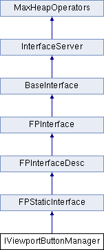

A manager to control the usage of the viewport buttons.
A Manager that the developer uses to register viewport buttons. It also contains helper function to provide global hittesting and per button hittesting. The developer can use these from within the OnAction callback. The manager is not responsible for deleting the manager. The developer should Unregister and then delete the button
To use IViewportButtonManager simply use static_cast<IViewportButtonManager*>(GetCOREInterface(IVIEWPORTBUTTONMANAGER_INTERFACE ))
