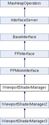

+ Inheritance diagram for IViewportShaderManager:
