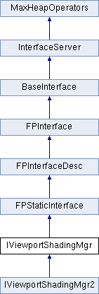

Viewport manager to control general illumination, including shadow support in the viewport.
New to 3ds Max 2008, the IViewportShadingMgr gives access to the new viewport Shading feature. The viewports have been redesigned to support more realistic rendering including Shadows. The interface also provides access to various flags that control how lights are used in the viewport. This is used closely with the new INodeShadingProperites API, that manages the actual flags set by IViewportShadingMgr The developer can get access to the CORE interface by using
| virtual void | SetViewportShadingLimits (int limit, bool bQuiet=true)=0 |
|  | Define the viewports shading quality.  More...
| virtual int | GetViewportShadingLimits ()=0 |
|  | Retrieve the viewport quality.  More...
| virtual bool | GetAutoDisplayOfSelLights ()=0 |
|  | Get the current state of the Auto Display Selected light flag.  More...
| virtual void | SetAutoDisplayOfSelLights (bool bSet)=0 |
|  | Set the state of the Auto Display of Selected lights flag.  More...
| virtual void | SetCastShadowDefaultLights (bool bSet)=0 |
|  | Flag controlling shadow generation for default lights.  More...
| virtual bool | GetCastShadowDefaultLights ()=0 |
|  | Access the flag defining whether shadows are generated for default lights.  More...
| virtual void | DisplayOnlySelectedLights ()=0 |
|  | A method that defines that the current selected lights will be part of viewport rendering.  More...
| virtual void | LockSelectedLights (bool bSet)=0 |
|  | Lock the current selected lights.  More...
| virtual void | GetViewportShadingLights (Tab< INode * > &lightList, int type)=0 |
|  | A method to retrieve lights based on the usage in the scene.  More...
| virtual void | SetGlobalShadowIntensity (float intensity)=0 |
|  | Sets the global intensity override for the shadows.  More...
| virtual float | GetGlobalShadowIntensity ()=0 |
|  | Retrieve the Global shadow intensity.  More...
| virtual void | SetUseTransparencyInShadows (bool bSet)=0 |
|  | Defines whether the viewport shading code supports transparent object/materials in the shadow code.  More...
| virtual bool | GetUseTransparencyInShadows ()=0 |
|  | Get the current Transparency in shadows flag.  More...
| virtual void | SetUpdateShadowInActiveViewOnly (bool bSet)=0 |
|  | Defines whether the viewport shading code updates the shadows for all windows or just the active viewport.  More...
| virtual bool | GetUpdateShadowInActiveViewOnly ()=0 |
|  | Get the current update shadow in active view only flag.  More...
| virtual bool | IsShadingLimitValid (int limit)=0 |
|  | Determine whether the shading limit is compatible with the current graphics hardware.  More...
| virtual Color | GetLightIconColor (INode &lightNode)=0 |
|  | Get the light icon color based on the current viewport shading limits.  More...
| virtual void | SetUseTransparencyInGI (bool bSet)=0 |
|  | Set whether the GI viewport system works with Transparent objects.  More...
| virtual bool | GetUseTransparencyInGI ()=0 |
|  | Get whether the GI viewport system uses Transparency.  More...
| virtual void | SetShadowFilterSize (float filterSize)=0 |
|  | Set the shadow filter size of soft-edge shadow.  More...
| virtual float | GetShadowFilterSize ()=0 |
|  | Get the shadow filter size of soft-edge shadow.  More...
