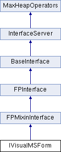

+ Inheritance diagram for IVisualMSForm:
