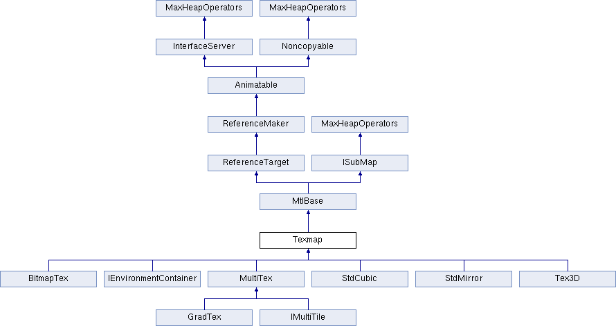

+ Inheritance diagram for Texmap:

void FlagDependents (TimeValue t, PartID which=PART_PUT_IN_FG)
 This sends the REFMSG_FLAGDEPENDENTS message up the pipeline. More...
virtual void NotifyForeground (TimeValue t)
 This method is called to flag dependents into the FG. More...
virtual void NotifyTarget (int message, ReferenceMaker *hMaker)
 Sends messages to ReferenceTargets. More...
CoreExport ReferenceTarget ()
 Constructor. More...
virtual CoreExport RefResult AutoDelete ()
 Deletes the object when it has no more real dependents. More...
CoreExport RefResult MaybeAutoDelete ()
- Public Member Functions inherited from ReferenceMaker
CoreExport RefResult ReplaceReference (int which, RefTargetHandle newtarg, BOOL delOld=TRUE)
 Used when cloning reference makers. More...
CoreExport RefResult DeleteAllRefsFromMe ()
 Deletes all references from this ReferenceMaker. More...
CoreExport RefResult DeleteAllRefs ()
 Deletes all references both to and from this item. More...
CoreExport RefResult DeleteReference (int i)
 Deletes the specified reference. More...
virtual BOOL CanTransferReference (int i)
 Tells whether this reference can be transfered. More...
CoreExport ReferenceSaveManagerGetReferenceSaveManager ()
 Access the ReferenceSaveManager of this ReferenceMaker. More...
virtual int RemapRefOnLoad (int iref)
 Used to load old files with references. More...
virtual CoreExport void RescaleWorldUnits (float f)
 Rescale size of all world units in reference hierarchy. More...
virtual CoreExport void SaveEnum (SaveEnumProc &sep, BOOL isNodeCall=0)
 The default save enumeration. More...
virtual CoreExport bool SpecifySaveReferences (ReferenceSaveManager &referenceSaveManager)
 Used to specify reference slot remapping during scene file save. More...
CoreExport int DoEnumDependents (DependentEnumProc *dep)
 Begins an enumeration that searches back in the dependency network. More...
CoreExport bool EnumRefHierarchy (RefEnumProc &proc, bool includeCustAttribs=true, bool includeIndirectRefs=true, bool includeNonPersistentRefs=true, bool preventDuplicatesViaFlag=true)
 This method provides a general purpose reference enumerator. More...
CoreExport int FindRef (RefTargetHandle rtarg)
 Get the index of the ReferenceTarget. More...
virtual BOOL IsRefMaker ()
 Tells whether it is a ReferenceMaker. More...
virtual BOOL IsRealDependency (ReferenceTarget *rtarg)
 Returns whether this is a "real" (strong) dependency or not. More...
virtual BOOL ShouldPersistWeakRef (RefTargetHandle rtarg)
 Specifies whether a weak reference is to be persisted on a partial load or save. More...
CoreExport ReferenceMaker ()
CoreExport void DeleteMe ()
 Deletes an instance of this class. More...
virtual CoreExport int NumRefs ()
 Returns the total number of references this ReferenceMaker can hold. More...
virtual CoreExport RefTargetHandle GetReference (int i)
 Returns the 'i-th' reference. More...
- Public Member Functions inherited from Animatable
virtual void FreeCaches ()
virtual int NumChildren ()
virtual AnimatableChildAnim (int i)
virtual CoreExport MSTR NodeName ()
virtual void EditTrack ()
virtual CoreExport BOOL SubAnimSetKeyBufferPresent (int subNum)
 returns true if the sub-anim has a "Set Key" buffer present More...
virtual BOOL SetKeyBufferPresent ()
 returns true if there is a "Set Key" buffer present More...
virtual CoreExport void SubAnimCommitSetKeyBuffer (TimeValue t, int subNum)
 Commit any "Set Key" buffers on the given sub-anim. More...
virtual void CommitSetKeyBuffer (TimeValue t)
 Commit any "Set Key" buffers. More...
virtual CoreExport void SubAnimRevertSetKeyBuffer (int subNum)
 Revert any "Set Key" buffers on the given sub-anim. More...
virtual void RevertSetKeyBuffer ()
 Revert any "Set Key" buffers. More...
virtual LRESULT CALLBACK TrackViewWinProc (HWND hwnd, UINT message, WPARAM wParam, LPARAM lParam)
 This function is obsolete. More...
virtual bool IsParamBlockDesc2Used (ParamBlockDesc2 *desc)
 Returns true if the passed description is being used. More...
virtual bool GetMacroRecorderName (bool used_as_rhs_value, MSTR &objectSpecifiedName)
 This method is called to access the object specified name to use for the Maxscript macrorecorder. More...
CoreExport Animatable ()
virtual CoreExport void DeleteThis ()
MSTR ClassName () const
 Returns the name of the plugin class. More...
virtual void BeginEditParams (IObjParam *ip, ULONG flags, Animatable *prev=NULL)
virtual void EndEditParams (IObjParam *ip, ULONG flags, Animatable *next=NULL)
virtual CoreExport void ReleaseInterface (ULONG id, void *i)
CoreExport void AppendProperty (AnimProperty *prop)
 A function to directly add arbitrary properties to this object developers should ensure that the properties ID does not conflict with any Max-specific IDs. More...
CoreExport AnimPropertyFindProperty (DWORD id)
 Find any property. More...
CoreExport void AddAppDataChunk (const Class_ID &cid, SClass_ID sid, DWORD sbid, DWORD len, void *data)
 Adds application/plugin specific (custom) data to an Animatable. More...
CoreExport AppDataChunkGetAppDataChunk (const Class_ID &cid, SClass_ID sid, DWORD sbid)
 Retrieves the application/plugin specific (custom) data stored with an Animatable. More...
CoreExport BOOL RemoveAppDataChunk (const Class_ID &cid, SClass_ID sid, DWORD sbid)
 Deletes the application/plugin specific (custom) data stored with an Animatable. More...
CoreExport void ClearAllAppData ()
 Deletes all application/plugin specific (custom) data stored with an Animatable. More...
virtual int NumSubs ()
virtual AnimatableSubAnim (int i)
virtual CoreExport MSTR SubAnimName (int i)
virtual BOOL CanDeleteSubAnim (int i)
virtual void DeleteSubAnim (int i)
virtual DWORD GetSubAnimCurveColor (int subNum)
virtual int SubNumToRefNum (int subNum)
virtual BOOL CanCopyAnim ()
CoreExport int HasSubElements (int type=0)
virtual int GetSubFCurveExtents (int subNum, ParamDimensionBase *dim, float &min, float &max, DWORD flags)
 The values max and min should be initialized before calling this function. More...
virtual ParamDimensionGetParamDimension (int i)
virtual BOOL SelectSubAnim (int subNum)
virtual BOOL BypassTreeView ()
virtual BOOL BypassTrackBar ()
virtual BOOL BypassPropertyLevel ()
virtual BOOL InvisibleProperty ()
virtual int NumKeys ()
virtual TimeValue GetKeyTime (int index)
virtual int GetKeyIndex (TimeValue t)
virtual BOOL GetNextKeyTime (TimeValue t, DWORD flags, TimeValue &nt)
virtual void CopyKeysFromTime (TimeValue src, TimeValue dst, DWORD flags)
virtual void DeleteKeyAtTime (TimeValue t)
virtual BOOL IsKeyAtTime (TimeValue t, DWORD flags)
virtual int GetKeyTimes (Tab< TimeValue > &times, Interval range, DWORD flags)
virtual int GetKeySelState (BitArray &sel, Interval range, DWORD flags)
CoreExport void OpenTreeEntry (int type, DWORD tv)
CoreExport void CloseTreeEntry (int type, DWORD tv)
CoreExport int IsTreeEntryOpen (int type, DWORD tv)
CoreExport BOOL GetSelInTrackView (DWORD tv)
CoreExport void SetSelInTrackView (DWORD tv, BOOL sel)
CoreExport BOOL InTrackViewSelSet (int which)
CoreExport void SetTrackViewSelSet (int which, BOOL inOut)
virtual BOOL AssignController (Animatable *control, int subAnim)
virtual BOOL CanAssignController (int subAnim)
 Return true if we can reassign the subanim specified. More...
virtual BOOL CanMakeUnique ()
CoreExport int EnumAnimTree (AnimEnum *animEnum, Animatable *client, int subNum)
virtual int RenderBegin (TimeValue t, ULONG flags=0)
virtual int RenderEnd (TimeValue t)
virtual CoreExport Interval GetTimeRange (DWORD flags)
virtual void EditTimeRange (Interval range, DWORD flags)
virtual void DeleteTime (Interval iv, DWORD flags)
virtual void ReverseTime (Interval iv, DWORD flags)
virtual void ScaleTime (Interval iv, float s)
virtual void InsertTime (TimeValue ins, TimeValue amount)
virtual BOOL SupportTimeOperations ()
virtual CoreExport void MapKeys (TimeMap *map, DWORD flags)
virtual void DeleteKeys (DWORD flags)
virtual void DeleteKeyByIndex (int index)
virtual void SelectKeys (TrackHitTab &sel, DWORD flags)
virtual void SelectSubKeys (int subNum, TrackHitTab &sel, DWORD flags)
virtual void SelectSubCurve (int subNum, BOOL sel)
virtual void SelectKeyByIndex (int i, BOOL sel)
virtual BOOL IsKeySelected (int i)
virtual void FlagKey (TrackHitRecord hit)
virtual int GetFlagKeyIndex ()
virtual int NumSelKeys ()
virtual void CloneSelectedKeys (BOOL offset=FALSE)
virtual void AddNewKey (TimeValue t, DWORD flags)
virtual void MoveKeys (ParamDimensionBase *dim, float delta, DWORD flags)
virtual void ScaleKeyValues (ParamDimensionBase *dim, float origin, float scale, DWORD flags)
virtual void SelectCurve (BOOL sel)
virtual BOOL IsCurveSelected ()
 Returns TRUE if the function curve is selected; otherwise returns FALSE. More...
virtual BOOL IsSubCurveSelected (int subNum)
 Returns the selected state of the sub-curve whose index is passed. More...
virtual int GetSelKeyCoords (TimeValue &t, float &val, DWORD flags)
virtual void SetSelKeyCoords (TimeValue t, float val, DWORD flags)
virtual int SetSelKeyCoordsExpr (ParamDimension *dim, const MCHAR *timeExpr, const MCHAR *valExpr, DWORD flags)
virtual void AdjustTangents (TrackHitRecord hit, ParamDimensionBase *dim, Rect &rcGraph, float tzoom, int tscroll, float vzoom, int vscroll, int dx, int dy, DWORD flags)
virtual void AdjustTangents (TrackHitRecord hit, ParamDimensionBase *dim, float angle, float length, DWORD flags)
virtual CoreExport BOOL IsAnimated ()
virtual BOOL CanCopyTrack (Interval iv, DWORD flags)
virtual BOOL CanPasteTrack (TrackClipObject *cobj, Interval iv, DWORD flags)
virtual TrackClipObjectCopyTrack (Interval iv, DWORD flags)
virtual void PasteTrack (TrackClipObject *cobj, Interval iv, DWORD flags)
virtual BOOL CanCopySubTrack (int subNum, Interval iv, DWORD flags)
virtual BOOL CanPasteSubTrack (int subNum, TrackClipObject *cobj, Interval iv, DWORD flags)
virtual TrackClipObjectCopySubTrack (int subNum, Interval iv, DWORD flags)
virtual void PasteSubTrack (int subNum, TrackClipObject *cobj, Interval iv, DWORD flags)
virtual int GetTrackVSpace (int lineHeight)
virtual int HitTestTrack (TrackHitTab &hits, Rect &rcHit, Rect &rcTrack, float zoom, int scroll, DWORD flags)
virtual int PaintTrack (ParamDimensionBase *dim, HDC hdc, Rect &rcTrack, Rect &rcPaint, float zoom, int scroll, DWORD flags)
virtual int PaintSubTrack (int subNum, ParamDimensionBase *dim, HDC hdc, Rect &rcTrack, Rect &rcPaint, float zoom, int scroll, DWORD flags)
virtual int PaintFCurves (ParamDimensionBase *dim, HDC hdc, Rect &rcGraph, Rect &rcPaint, float tzoom, int tscroll, float vzoom, int vscroll, DWORD flags)
virtual int HitTestFCurves (ParamDimensionBase *dim, TrackHitTab &hits, Rect &rcHit, Rect &rcGraph, float tzoom, int tscroll, float vzoom, int vscroll, DWORD flags)
virtual int PaintSubFCurves (int subNum, ParamDimensionBase *dim, HDC hdc, Rect &rcGraph, Rect &rcPaint, float tzoom, int tscroll, float vzoom, int vscroll, DWORD flags)
virtual int HitTestSubFCurves (int subNum, ParamDimensionBase *dim, TrackHitTab &hits, Rect &rcHit, Rect &rcGraph, float tzoom, int tscroll, float vzoom, int vscroll, DWORD flags)
virtual void EditTrackParams (TimeValue t, ParamDimensionBase *dim, const MCHAR *pname, HWND hParent, IObjParam *ip, DWORD flags)
virtual int TrackParamsType ()
virtual int GetFCurveExtents (ParamDimensionBase *dim, float &min, float &max, DWORD flags)
 This method is called to calculate the largest and smallest values of the anim. More...
CoreExport void AddNoteTrack (NoteTrack *note)
CoreExport void DeleteNoteTrack (NoteTrack *note, BOOL delNote=TRUE)
CoreExport BOOL HasNoteTracks ()
CoreExport int NumNoteTracks ()
CoreExport NoteTrackGetNoteTrack (int i)
virtual void FreeAllBitmaps ()
virtual void GetSystemNodes (INodeTab &nodes, SysNodeContext Context)
virtual BOOL IsSubClassOf (Class_ID classID)
 returns true if the animatable has sub-classed off the given class More...
virtual CoreExport void MouseCycleCompleted (TimeValue t)
virtual CoreExport void MouseCycleStarted (TimeValue t)
virtual int NumParamBlocks ()
virtual IParamBlock2GetParamBlock (int i)
virtual IParamBlock2GetParamBlockByID (short id)
CoreExport bool SvSaveData (ISave *isave, USHORT id)
CoreExport bool SvLoadData (ILoad *iLoad)
CoreExport DWORD SvGetRefIndex ()
CoreExport void SvSetRefIndex (DWORD i)
CoreExport bool SvDeleteRefIndex ()
CoreExport SvGraphNodeReference SvStdTraverseAnimGraph (IGraphObjectManager *gom, Animatable *owner, int id, DWORD flags)
virtual CoreExport bool SvCanInitiateLink (IGraphObjectManager *gom, IGraphNode *gNode)
virtual CoreExport bool SvCanConcludeLink (IGraphObjectManager *gom, IGraphNode *gNode, IGraphNode *gNodeChild)
virtual CoreExport bool SvCanRemoveThis (IGraphObjectManager *gom, IGraphNode *gNode)
virtual CoreExport bool SvRemoveThis (IGraphObjectManager *gom, IGraphNode *gNode)
 Called when the user deletes this object in the schematic view... More...
virtual CoreExport bool SvIsHighlighted (IGraphObjectManager *gom, IGraphNode *gNode)
virtual CoreExport COLORREF SvGetSwatchColor (IGraphObjectManager *gom, IGraphNode *gNode)
virtual CoreExport bool SvIsInactive (IGraphObjectManager *gom, IGraphNode *gNode)
virtual CoreExport bool SvLinkChild (IGraphObjectManager *gom, IGraphNode *gNodeThis, IGraphNode *gNodeChild)
virtual CoreExport bool SvEditProperties (IGraphObjectManager *gom, IGraphNode *gNode)
virtual CoreExport MSTR SvGetTip (IGraphObjectManager *gom, IGraphNode *gNode)
virtual CoreExport MSTR SvGetRefTip (IGraphObjectManager *gom, IGraphNode *gNode, IGraphNode *gNodeMaker)
virtual CoreExport bool SvCanDetach (IGraphObjectManager *gom, IGraphNode *gNode)
virtual CoreExport bool SvDetach (IGraphObjectManager *gom, IGraphNode *gNode)
virtual CoreExport MSTR SvGetRelTip (IGraphObjectManager *gom, IGraphNode *gNodeTarget, int id, IGraphNode *gNodeMaker)
 Returns a string to be displayed in the tip window in the schematic view for a relationship from "gNodeMaker" to "gNodeTarget"... More...
virtual CoreExport bool SvCanDetachRel (IGraphObjectManager *gom, IGraphNode *gNodeTarget, int id, IGraphNode *gNodeMaker)

SClass_ID SuperClassID ( )
inlinevirtual
Retrieves a constant representing the type of the plugin.
Returns
A super class id that uniquely identifies the type (category) of the plugin. Note that several plugin classes can be of the same type, thus return the same super class id. Plugins are uniquely identified by their class ids.
See also
SClass_ID
Reimplemented from ReferenceTarget.
154 { return TEXMAP_CLASS_ID; }
#define TEXMAP_CLASS_ID
Texture maps super-class ID.
Definition: plugapi.h:424
virtual void GetClassName ( MSTR s)
inlinevirtual
Retrieves the (localizable) name of the plugin class.
This name is usually used internally for debugging purposes. For Material plug-ins this method is used to put up the material "type" name in the Material Editor.
Parameters
sReference to a string filled in with the name of the plugin class
155 { s= MSTR(_M("Texture")); }
#define _M(x)
Used to wrap string literals.
Definition: strbasic.h:67
WStr MSTR
Definition: strclass.h:1058
virtual AColor EvalColor ( ShadeContext sc)
pure virtual
Remarks
This method is called to evaluate the color of the texture map for the context. This is for channels that have a color such as diffuse, specular, ambient, etc. This method is called for every pixel of the texture.
Parameters:
ShadeContext& sc
Describes the properties of the pixel to evaluate.
Returns
An AColor object which stores the r, g, b, a values. Note: The alpha is pre multiplied, and the alpha value goes into AColor::a.
virtual float EvalMono ( ShadeContext sc)
inlinevirtual
Remarks
Evaluate the map for a "mono" channel. Mono channels are those that don't have a color, but rather a single value. This is for things like shininess, transparency, etc. This just permits a bit of optimization.
Parameters:
ShadeContext& sc
Returns
A floating point value for the mono channel.
Default Implementation:
{return Intens(EvalColor(sc));}
183  {
184  return Intens(EvalColor(sc));
185  }
static float Intens(const AColor &c)
Definition: acolor.h:334
virtual AColor EvalColor(ShadeContext &sc)=0
virtual Point3 EvalNormalPerturb ( ShadeContext sc)
pure virtual
Remarks
This method is used for bump mapping to retrieve a perturbation to apply to a normal.
Parameters:
ShadeContext& sc
Returns
A deflection vector for perturbing the normal.
virtual BOOL HandleOwnViewPerturb ( )
inlinevirtual
Remarks
This query is made of maps plugged into the Reflection or Refraction slots: Normally the view vector is replaced with a reflected or refracted one before calling the map: if the plugged in map doesn't need this, it should return TRUE.
{ return FALSE; }
207 { return FALSE; }
virtual CoreExport BITMAPINFO* GetVPDisplayDIB ( TimeValue  t,
TexHandleMaker thmaker,
Interval valid,
BOOL  mono = FALSE,
int  forceW = 0,
int  forceH = 0
virtual
Remarks
This gets the viewport display bitmap in DIB format, useful when combining several maps for hardware-supported multiple texture display. If mono is TRUE, the map should do a mono evaluation and place the result in RGB. forceW and forceH, if non-zero, override dimensions specified by thmaker.
Parameters:
TimeValue t
The time to get the bitmap at.
TexHandleMaker& thmaker
This class provides methods for creating a texture handle from a 3ds Max bitmap and a Windows DIB. It also has a method to retrieve the required size of the texture map. See Class TexHandleMaker.
Interval &valid
The validity interval of the returned bitmap.
BOOL mono
Indicates whether a map should do mono evaluation.
int forceW
Overrides the bitmap width usually supplied by thmaker.
int forceH
Overrides the bitmap height usually supplied by thmaker.
virtual void GetUVTransform ( Matrix3 uvtrans)
inlinevirtual
Remarks
This method is called to retrieve the UV transformation matrix for use in the viewports. If a developer is using an instance of UVGen, a method of that class may be called to retrieve the value:
(i.e. { uvGen->GetUVTransform(uvtrans); } ).
Parameters:
Matrix3 &uvtrans
The transformation matrix is returned here.
247 { uvtrans.IdentityMatrix(); }
void IdentityMatrix()
virtual int GetTextureTiling ( )
inlinevirtual
Remarks
This method is called to get the tiling state of the texture for use in the viewports. This is described by a set of symmetry flags that may be ORed together. If you are using an instance of UVGen to handle the UV user interface you may simply call a method of UVGen to handle this.
For example: { return uvGen->GetTextureTiling(); }
Returns
See Texture Symmetry Flags.
{ return U_WRAP|V_WRAP; }
256 { return U_WRAP|V_WRAP; }
#define V_WRAP
Indicates the texture map is tiled in the V direction.
Definition: Texmap.h:25
#define U_WRAP
Indicates the texture map is tiled in the U direction.
Definition: Texmap.h:24
