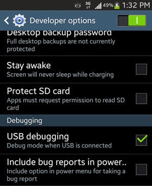

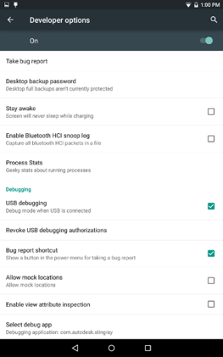

Enable USB debugging on the Android device. This is typically found in the device's Settings, under Developer options. Two examples:
If you don't see the Developer options on your device, you may need to enable them. Find the Android Build number in the device's settings, and tap the build number seven times.

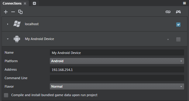

In the interactive editor, use the Connections panel (Windows > Deploy and Connect > Connections) to set up a connection to the Android device:
For details, see Using the Connections panel.
Note: In the Address field of the Connections panel, you must enter the IP address of your Android device. You can find this in your device's settings.
When you connect to the device or run the project, the editor automatically installs the engine on the device over the USB connection, runs the engine on the device, then sends your project data to the engine.

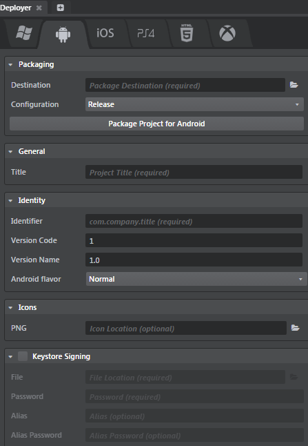

Deploying creates a standalone .apk bundle that you can try out on your device (and, eventually, distribute on the Google store). For background information, see Deploying and Building and Using the Deployer panel.
To package a project for Android:
The deployer creates an .apk file for your app, and copies it to the location on your computer that you specify in the Destination field.

You can set the following options in the Deployer panel for Android devices.
These settings are common for all tabs. See Using the Deployer panel.
Browse to select your app icon in PNG format. It can be any size, but we recommend a maximum of 512x512 pixels. If you leave this empty, the Deployer uses a default Autodesk icon.
Keystore signing is required in order to test the generated .apk file on a device or publish it on the store. If you don't enable the Keystore Signing section, the editor automatically uses the debug.keystore that is installed at the same time as the Android SDK at %USERPROFILE%/.android/debug.keystore.
