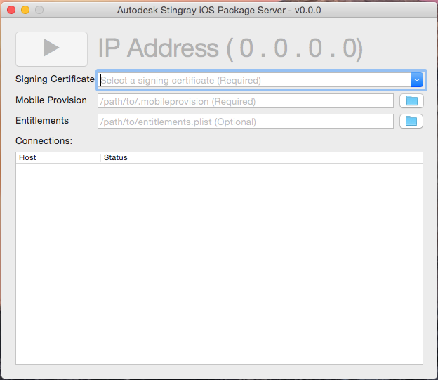

Run the app. The following window appears:
Enter the information required to start the server:
[Required] Specifies the certificate you want to use for signing your apps. Note you should use the Distribution certificate when you create a final version of your app that you plan to upload to iTunes Connect.
Note: The drop-down list shows all certificates installed on the machine. If you don't see anything there, and have to enter the value manually, chances are that you don't have the certificate installed on your machine. This may cause the packaging process to fail.
[Required] Point to the mobile provision file associated with your signing certificate. You can download this from your Apple Developer Center page.
Note: If you're not using an Enterprise provision profile (which lets you install on any device), make sure that you have added the devices you plan to use for testing to this provision profile. If you used Xcode to develop on this device previously, it is automatically added.

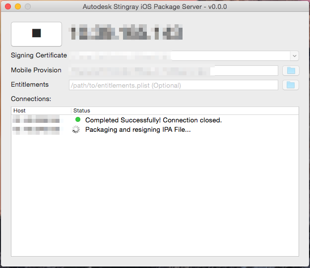

Start the server by pressing the play button. (At any time, press the stop button to stop the server.)
When the server starts, you'll see the IP address that you need to enter in order to generate the IPA for the interactive engine, and in order to package your own interactive application for iOS (see the sections below).
You will also see a list of all requests coming in from interactive editors running on your network:
Tip: Double-click a status message to view the full log data.

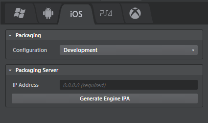

In the interactive editor on your Windows development machine, open the Deployer panel (Window > Deploy and Connect > Deployer) to the iOS tab.
Select an engine configuration. You'll need to generate the "Development" .ipa in order to connect the editor to an iOS device for testing, and you'll need to generate the "Release" .ipa for your final deployment. See also About engine configurations.
Click Generate Engine IPA.
The file is created and saved in your Windows user directory, typically under AppData\Local\Autodesk\ Interactive\engine\ios\<configuration>.

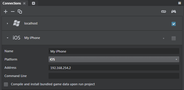

In the interactive editor, use the Connections panel (Window > Deploy and Connect > Connections) to set up the connection to the IP address shown on the device, then mirror or run project.
For details, see Using the Connections panel.
Note: The engine app on the device must be in this waiting state in order for the editor to initiate a connection. That means that each time you want to run your project or mirror your viewport, you have to close and restart the engine on the device.

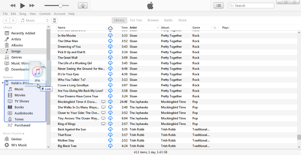

To copy your deployed app to a connected device for testing, use iTunes on your Windows computer.
If you're using version 12.6.x or earlier, drag and drop your .ipa into your Apps library, then sync your device.
If you're using version 12.7 or later, drag your .ipa over your device's entry in the vertical ribbon. Your device is outlined in blue to indicate that the app will be copied:
Tip: This method may not work for all devices. If it doesn't work for you, try installing the special 12.6.3 version of iTunes that adds back the Apps library. If this fails, you may have to copy the .ipa to your Mac OS X machine and transfer it from there using Xcode.

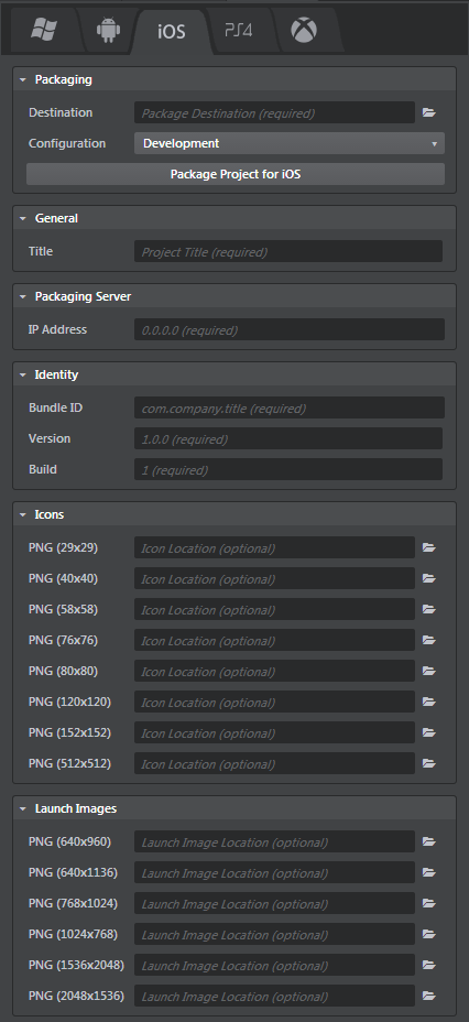

You can set the following options in the Deployer panel for iOS devices, after you have created the .ipa file for the engine.
These settings are common for all tabs. See Using the Deployer panel.
Icons used for your app. If you leave them empty, the Deployer uses a default Autodesk icon. When you are ready to release your app, you'll need to specify an icon for each listed size.
The Launch images (splash screens) used for your app. If you leave them empty, the Deployer uses a default Autodesk image. When you are ready to release your app, you'll need to specify an icon for each listed size.
