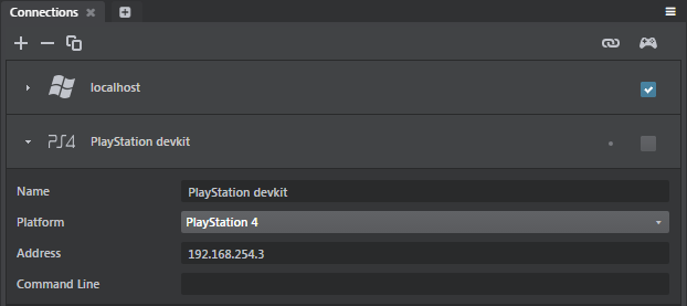

To connect to a PlayStation 4:
In the interactive editor, use the Connections panel (Window > Deploy and Connect > Connections) to set up a connection to the PlayStation 4 device:
For details, see Using the Connections panel.
When you connect to the device or run the project, the editor automatically installs the engine on the device over the network, runs the engine on the device, then sends your project data to the engine.

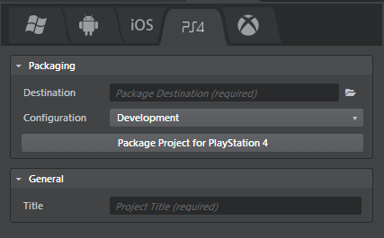

Step 3. Deploy the project for PlayStation 4
Deploying creates a standalone bundle that you can try out on your PlayStation 4 (and, eventually, distribute). For background information, see Deploying and Building and Using the Deployer panel.
To package a project for PlayStation 4:
  1. In the interactive editor, open the Deployer panel (Window > Deploy and Connect > Deployer) to the PlayStation 4 tab and enter the required information. (See below.)
  2. Click Package Project for PlayStation 4.
The deployer copies the files your app needs to the location on your computer that you specify in the Destination field.

PlayStation 4 deployment settings
You can set the following options in the Deployer panel for PlayStation 4 devices.
Packaging settings
These settings are common for all tabs. See Using the Deployer panel.
General settings
Title
The title of your project. This sets the name of the executable file for the application, and the product name for online stores.
