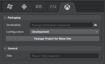

Deploying creates a standalone bundle that you can try out on your Xbox One (and, eventually, distribute). For background information, see Deploying and Building and Using the Deployer panel.
To package a project for Xbox One:
The deployer copies the files your app needs to the location on your computer that you specify in the Destination field.
After deploying, you can use the development tools provided by Microsoft to copy your app to an Xbox One device for testing, and to finish preparing your app for distribution using any of the channels supported by Microsoft.
You can set the following options in the Deployer panel for Xbox One devices.
These settings are common for all tabs. See Using the Deployer panel.
