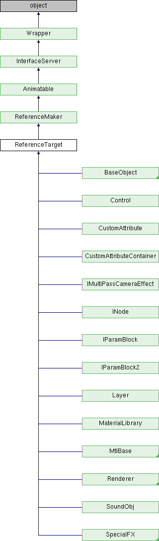

ReferenceTarget Class Reference
+ Inheritance diagram for ReferenceTarget:
Public Member Functions

Detailed Description
A scene entity that is being observed by other scene entities.
