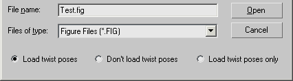

Clicking Load File brings the Open dialog, from which you can pick a FIG file and choose from the following twist poses options:
Load Twist Poses Only: Loads only the twist poses data without the twist links.
Note: The Twist and Bias values are not used without twist links. Refer to the
Twist Poses rollout for details.

- In the file dialog, choose the figure file to load.
- Choose one of the three loading options, depending on whether or not you want to load twist poses, or to load twist poses only.
- Click OK.
