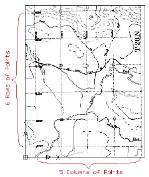

  5. Note that the image contains 6 rows and 5 columns of points that would approximate the grid contained in the image. In the Points section, enter 6 rows and 5 columns. Note the total number of points in the grid is shown so you know how many points can be used in the rubbersheet operation.
    This example shows the rows and columns in the image.
