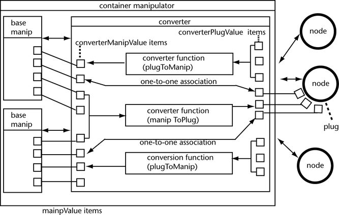

Manipulators communicate with plugs on nodes to set the values of the plugs. Additionally, manipulators also set the manipulator values with respect to the values of the plugs.
The communication between manipulators and nodes is done in one of these two ways: simple one-to-one associations, or through complex conversion functions. The following diagram illustrates the communication between nodes and manipulators.
The converter manages the communication between the plugs on the nodes and manipulator values. The arrows in the diagram indicate the direction in which the information flows. Each container manipulator has one converter, which is the interface between the children manipulators and the affected plugs.
The square boxes indicate the data items on the converter and the base manipulators. The items on the converter that are related to the children manipulator values are called the converterManipValue items. The items on the converter that are related to the node plug values are called the converterPlugValue items.
The items on the base manipulators are called the manipValue items. Some manipValue items relate directly to an affordance of the manipulator. For example, MFnDiscManip::angleIndex()
relates directly to the rotation affordance of the DiscManip. Other manipValue items do not relate to an affordance of the manipulator, but provide important information on the position or orientation of the manipulator such as MFnDiscManip::centerIndex()
and MFnDiscManip::axisIndex()
Each converterManipValue item and converterPlugValue item has an integer index to uniquely identify the item. Each manipValue item on a base manipulator also has an integer index to uniquely identify the item.
As shown in the diagram, there are one-to-one associations directly between a converterManipValue item and a converterPlugValue item.
More complex conversions between converterManipValue items and converterPlugValue items are performed through conversion functions. These functions can use any number of converterPlugValue items or converterManipValue items to calculate the corresponding converterManipValue or converterPlugValue item.
One-to-one association synchronizes the manipulator values with the plug values. In other words, the manipulator value equals the plug value, and vice versa.

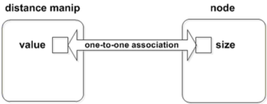

The following figure shows the one-to-one association between the distance manipulator value and the value of the size plug on a node.
After you set the one-to-one association, whenever the manipulator value changes, the corresponding plug value also changes, and vice versa.

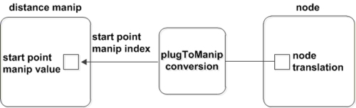

A plugToManip conversion callback is used to get the value of a converterManipValue item from various converterPlugValue items. This callback has access to all the converterPlugValue items and returns the value of a converterManipValue item.
The plugToManip conversion is implemented by calling MPxManipContainer::addPlugToManipConversionCallback()
Each visual control property has a corresponding index registered with the manipulator. To set the plugToManip conversion relationship, when MPxManipContainer::addPlugToManipConversionCallback()
is called, the index of the manipulator value must be passed. In each base manipulator function set class, there are functions to retrieve different indices for individual properties.
The following code from footPrintManip illustrates how to retrieve the index of the starting point of the manipulator and pass it to the addPlugToManipConversionCallback()
function call. The second parameter of this function call is the callback conversion function, which calculates the manipulator value of the starting point based on some plug values.
unsigned startPointIndex = distanceManipFn.startPointIndex();
addPlugToManipConversionCallback (startPointIndex,(plugToManipConversionCallback)&footPrintLocatorManip::startPointCallback);
The plugToManip conversion callback accesses the plug values, calculates the manipulator values based on the custom algorithm, and returns them. In this example, the callback function does not request the plug values, instead, it retrieves the node translation in world space and returns this value. By doing so, it actually sets the start point manipulator value to be the same as the node translation. The result is that whenever the node moves, the manipulator moves along with it, and always appears in the center of the node.
MManipData footPrintLocatorManip::startPointCallback(unsigned index) const {
MFnNumericData numData;
MObject numDataObj =numData.create(MFnNumericData::k3Double);
MVector vec = nodeTranslation();
numData.setData (vec.x, vec.y, vec.z);
return(MManipData (numDataObj));
The conversion callback returns a data type called MManipData and sets the manipulator value to what the MManipData represents.

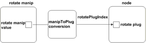

A manipToPlug conversion callback is used to get the value of a converterPlugValue item from various converterManipValue items. This callback has access to all the converterManipValue items and returns the value of a converterPlugValue item.
The manipToPlug conversion is implemented by calling MPxManipContainer::addManipToPlugConversionCallback()
. The corresponding plug needs to be passed in as the first parameter because the callback needs to know which plug values to change.
The following code from the rotateManip example demonstrates using this technique with the node's rotate plug passed in.
MFnDependencyNode nodeFn (node);
MPlug rPlug =nodeFn.findPlug ("rotate", &stat);
rotatePlugIndex = addManipToPlugConversionCallback(rPlug,(manipToPlugConversionCallback)&exampleRotateManip::rotationChangedCallback);
The addManipToPlugConversionCallback()
function call returns the index rotatePlugIndex
to identify which plug is registered with this callback. When the actual callback function is invoked, the index of the plug value to be calculated is passed in as the parameter of the function call. The callback function then determines if the passed-in value is the index that is registered for this callback. If there is more than one plug registered with this callback, a condition statement can be used to distinguish different passed-in plug index, and calculate corresponding manipulator values. In the following rotationChangedCallback()
example, the passed-in index is compared with rotatePlugIndex
. If they are equal, getConverterManipValue()
is called with rotate manipulator index to retrieve the rotate manipulator value. By returning the rotate manipulator value as a MManipData
object, this callback function is setting the rotate plug value to be the same as the rotate manipulator value. Depending on your specific requirement, more complex relationship between rotate plug value and rotate manipulator value can be set using conversion callback.
MManipData exampleRotateManip::rotationChangedCallback(unsigned index) {
MObject obj =MObject::kNullObj;
// If we entered the callback with an invalid index, print an error and
// return. Because, we registered the callback only for one plug, all
// invocations of the callback must be for that plug.
if (index != rotatePlugIndex) {
MGlobal::displayError("Invalid index in rotation changed callback!");
// For invalid indices, return vector of 0's
MFnNumericData numericData;
obj = numericData.create(MFnNumericData::k3Double);
numericData.setData (0.0, 0.0, 0.0);
return (obj);
obj =numericData.create(MFnNumericData::k3Double);
MEulerRotation manipRotation;
if (!getConverterManipValue(rotateManip.rotationIndex(),manipRotation)) {
MGlobal::displayError("Error retrieving manip value");
numericData.setData(0.0, 0.0, 0.0);
} else {
numericData.setData(manipRotation.x, manipRotation.y, manipRotation.z);
return MManipData(obj);
