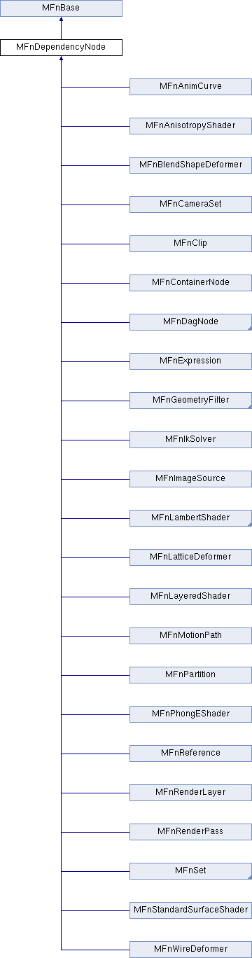

C++ API Reference
Dependency node function set. More...
#include <MFnDependencyNode.h>
Inheritance diagram for MFnDependencyNode:Public Types | |
MFnDependencyNode allows the creation and manipulation of dependency graph nodes. Traversal of the dependency graph is possible using the getConnections method.
This function set does not support creation or removal of connections. MDGModifier should be used for that purpose.
