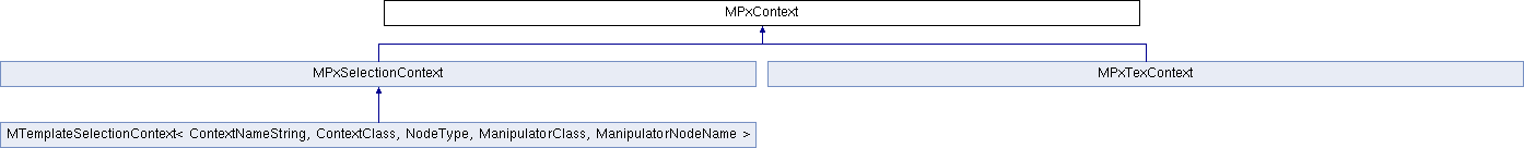

 Inheritance diagram for MPxContext:Public Types | |

Reimplemented in MTemplateSelectionContext< ContextNameString, ContextClass, NodeType, ManipulatorClass, ManipulatorNodeName >.

Reimplemented in MPxTexContext, and MPxSelectionContext.
