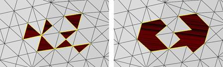

Left: Only one triangle is missing in each hole. They can be repaired with
Close Trivial Holes. Right:
All attempts to repair all holes regardless of complexity.

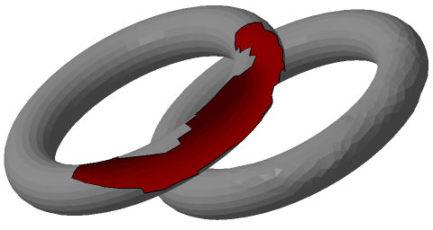

To close holes across curved surfaces
Closing a hole by adding triangles without considering the surrounding triangles' orientation is fast but does not preserve or regenerate the original shape, which becomes more apparent the more curved the area of the mesh is. For such cases, a method is available that attempts to recreate the original curved surface by sampling the surrounding triangle's orientation.
Note: This method only repairs one selected hole at a time and may take significantly longer than the other methods to finish.
- Find the hole that you want to have fixed.
- Right-click the hole's edge and choose
Select all surrounding triangles from the context menu.
- From the main menu, choose
- Make any required adjustments, then click
OK.
Options
Density Factor: Attempts to keep the newly generated triangles at a size equal to the sizes of the surrounding triangles times this value.
Smooth Factor: How strongly any smoothing should be performed, if any.
Scale Factor: A corrective value that adjusts the "bulginess" of the generated surface curve
Boundary Rotate Factor: If a bend or bulge with a dominant axis is determined, it may not align with the dominant curvature of the original mesh. Use this to rotate the axis to correct for such misalignment.
Close Flat: Foregoes any shape reconstruction and just closes the hole with effectively the smallest surface area possible.
The hole in the torus to the left has been fixed on the right.
