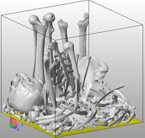

This packer lets parts settle on their own in the build room under simulated gravity.
