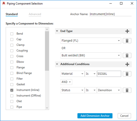

Standard Tab
Adds one or more objects to dimension anchors or exclusions. You can specify one or more end types to limit dimensioning to a component of a specific end type (for example, flanged valve). Apply conditions to piping components with a specific status, service, or other conditions.

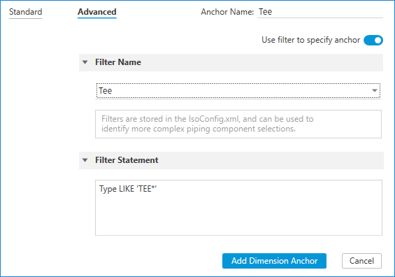

Advanced Tab
Allows filtering to specify anchor to select any existing filter as the dimension anchor or exclusion. Filters are stored in the IsoConfig.xml and can be used to identify more complex piping components selections.
