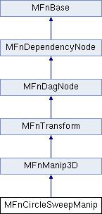

Inheritance diagram for MFnCircleSweepManip:Public Member Functions | |
