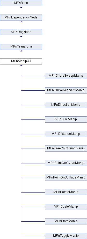

| virtual MFn::Type | type () const |
| | Function set type. More...
| virtual | ~MFnManip3D () |
| | Destructor. More...
| MFnManip3D () |
| | Default constructor.
| | MFnManip3D (MObject &object, MStatus *ReturnStatus=NULL) |
| | Constructor. More...
| | MFnManip3D (const MDagPath &object, MStatus *ret=NULL) |
| bool | isVisible (MStatus *ReturnStatus) const |
| | Returns whether or not the manipulator is visible. More...
| MStatus | setVisible (bool isVisible) |
| | Sets whether or not the manipulator is visible. More...
| float | manipScale (MStatus *ReturnStatus) const |
| | Returns the manipulator scale. More...
| MStatus | setManipScale (float size) |
| | Sets the manipulator scale. More...
| bool | isOptimizePlaybackOn (MStatus *ReturnStatus) const |
| | Returns whether or not optimize playback is on. More...
| MStatus | setOptimizePlayback (bool optimizePlayback) |
| | Sets whether or not to optimize the playback. More...
| MEulerRotation | rotateXYZValue (const unsigned int valIndex, MStatus *ReturnStatus=NULL) |
| | Gets the rotation for the active manipulator. More...
| | MFnManip3D (const MObject &object, MStatus *ret=NULL) |
