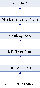

DistanceManip function set. More...
#include <MFnDistanceManip.h>
Inheritance diagram for MFnDistanceManip:Public Member Functions | |
