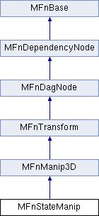

StateManip function set. More...
#include <MFnStateManip.h>
Inheritance diagram for MFnStateManip:Public Member Functions | |
