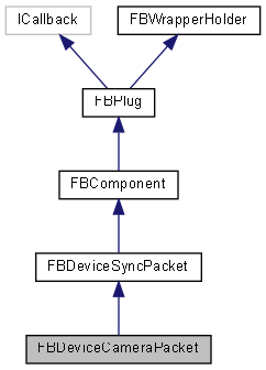

Inheritance diagram for FBDeviceCameraPacket:
