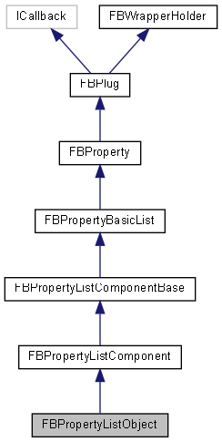

Inheritance diagram for FBPropertyListObject:

Detailed Description
List of scene objects.
This list is a more generic container often used as object properties. The types of actual object that it can contain can be specialized.
