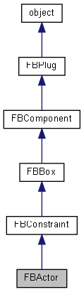

FBActor is used to link motion data to a character. More...
In MotionBuilder, an actor is a model used to link captured motion data to a character. Use functions in FBActor to set the body color, skeleton color, pivot color, marker size, pivot size, pivot information, etc. on an actor.These classes are under development and may change dramatically between versions.To obtain the list of actors present in a scene, you need to create an instance of class FBSystem, to obtain the current scene. The FBScene object holds the list of actors in the property Actors.
The current actor selected in the Character tool can be obtained via the FBApplication object.
