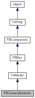

Camera switcher. More...
Public Member Functions | |
| FBCameraSwitcher () | |
| Constructor. More... | |
| bool | PlotToCamera (FBCamera pCamera) |
| Plot the Camera Switcher animation onto a destination camera. More... | |
