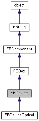

Base Device class. More...

Base Device class.
Cannot be instantiated from Python.
