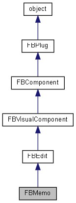

FBMemo Class Reference
Multi-line text input. More...
Inheritance diagram for FBMemo:
