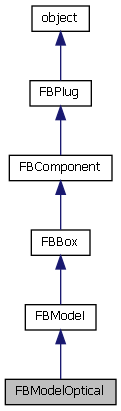

Optical model class. More...
Public Member Functions | |
| FBModelOptical (str pName) | |
| Constructor. More... | |
| ClearSegments (bool pUnUsedOnly=True) | |
| Clear the segments (by default only the unused). More... | |
| FBRigidBody | CreateRigidBody (str pRigidBodyName, FBArrayTemplate< FBModelMarkerOptical > pMarkers) |
| Create a new rigid body from the given optical markers. More... | |
| bool | ExportSetup () |
| Setup exportation from optical model. More... | |
| bool | ImportSetup () |
| Setup importation for optical model. More... | |
| FBModelOptical | ( | str | pName | ) |
Constructor.
| pName | Name of optical model. |
| ClearSegments | ( | bool | pUnUsedOnly = True | ) |
| pUnUsedOnly | Clear only the unused segments if true(default=true). |
| FBRigidBody CreateRigidBody | ( | str | pRigidBodyName, |
| FBArrayTemplate< FBModelMarkerOptical > | pMarkers | ||
| pRigidBodyName | The name for the new rigid body to create. If left empty, the default "Rigid Body" name will be used. |
| pMarkers | The optical markers for creating the new rigid body. |
| bool ExportSetup | ( | ) |
| bool ImportSetup | ( | ) |
| FBListModelMarkerOptical Markers |
List: Markers.
| float MarkerSize |
Read Write Property: Size of markers.
| FBListRigidBody RigidBodies |
List: Rigid bodies.
| FBTime SamplingPeriod |
Read Write Property:Sampling period.
| FBTime SamplingStart |
Read Write Property: Sampling start time.
| FBTime SamplingStop |
Read Write Property:Sampling stop time.
| FBListOpticalSegment Segments |
List: Segments.
