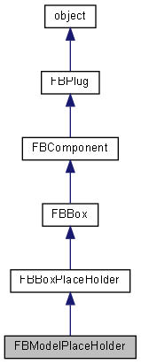

Wrapper around a specific instance of a FBModel object. More...
This class is mainly used with a constraint relation to have multiple boxes that are a representation of the same underlying model. Instantiation of FBModelPlaceHolder should be left to the the system.
Constructor.
| FBModel Model |
Read Only Property: Underlying model object.
| bool UseGlobalTransforms |
Read Write Property: Indicate if the translations are expressed in local or global mode.
