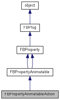

FBPropertyAnimatableAction Class Reference
Inheritance diagram for FBPropertyAnimatableAction:
