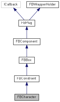

A character is the link between a motion source and a character model. More...
