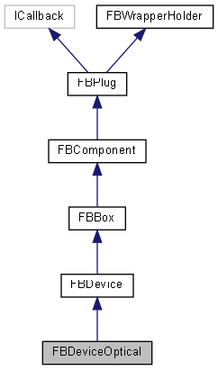

Optical device class. More...
#include <fboptical.h>
Definition at line 814 of file fboptical.h.
