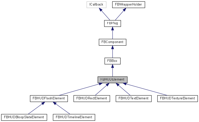

| virtual void | GetIntrinsicDimension (FBViewingOptions *pViewingOptins, int &pWidth, int &pHeight) |
| | Callback for getting HUD element intrinsic dimension which is opposed to the actual display dimension. More...
| virtual void | DrawElement (FBViewingOptions *pViewingOption, Rect &pRect) |
| | Callback for drawing HUD element. More...
| virtual bool | FbxStore (FBFbxObject *pFbxObject, kFbxObjectStore pStoreWhat) override |
| | Store function that can be overloaded. More...
| virtual bool | FbxRetrieve (FBFbxObject *pFbxObject, kFbxObjectStore pStoreWhat) override |
| | Retrieve function that can be overloaded. More...
| | FBBox (const char *pName, HIObject pObject=NULL) |
| | Constructor. More...
| virtual FBAnimationNode * | AnimationNodeInCreate (kReference pUserId, const char *pName, const char *pDataType, bool pIsPublic=false, double *pMin=NULL, double *pMax=NULL, bool pUserData=false) |
| | Creation of IN/OUT Animation Nodes. More...
virtual FBAnimationNode * | AnimationNodeOutCreate (kReference pUserId, const char *pName, const char *pDataType, bool pIsPublic=false, double *pMin=NULL, double *pMax=NULL, bool pUserData=false) |
| virtual bool | EvaluateAnimationNodes (FBEvaluateInfo *pEvaluateInfo) |
| | Evaluation of non TRS nodes that needs to be evaluated. More...
| virtual bool | AnimationNodeNotify (FBAnimationNode *pAnimationNode, FBEvaluateInfo *pEvaluateInfo) |
| | Notification function for animation thread. More...
| virtual bool | ResolveCandidate (FBAnimationNode *pAnimationNode, FBEvaluateInfo *pEvaluateInfo) |
| | Function is call when candidate needs to be resolved (like global to local). More...
| virtual ECandidateAction | SetGlobalCandidate (FBAnimationNode *pAnimationNode, double *pData, FBEvaluateInfo *pEvaluateInfo) |
| | Function is call when a global candidate is set on an animation node. More...
| virtual ECandidateAction | SetStdCandidate (FBAnimationNode *pAnimationNode, double *pData, FBEvaluateInfo *pEvaluateInfo) |
| | Function is call when a non-global candidate is set on an animation node. More...
| virtual bool | AnimationNodeDestroy (FBAnimationNode *pAnimationNode) |
| | Destroy an animation node. More...
| virtual bool | AnimationNodeIsUserData (FBAnimationNode *pAnimationNode) |
| | Is the animation node user data? More...
| virtual void | AnimationNodesOutDisableIfNotWritten (FBEvaluateInfo *pEvaluateInfo) |
| | This call will disable all out animation nodes from being pull by system (animation thread) for given pEvaluateInfo. More...
| virtual FBAnimationNode * | AnimationNodeInGet () |
| | Get the (IN/OUT) animation node for this box. More...
virtual FBAnimationNode * | AnimationNodeOutGet () |
| virtual const char * | FbxGetObjectType () |
| | Returns the class type inherited by the class of an object, for example: 'Box', 'Constraint', 'TimelineXTrack'. More...
| virtual const char * | FbxGetObjectSubType () |
| | Returns the class sub type inherited by the class of an object, for example: 'Relations', 'Parent-Child', 'Number to Vector', 'Shot'. More...
| IObject_Declare (override) |
| virtual int | GetOutConnectorCount () const |
| | Get the number of animation node outputs for this box. More...
| virtual int | GetInConnectorCount () const |
| | Get the number of animation node inputs for this box. More...
| virtual FBAnimationNode * | GetOutConnector (int pIndex) const |
| | Get the animation node output associated with the given index. More...
| virtual FBAnimationNode * | GetInConnector (int pIndex) const |
| | Get the animation node input associated with the given index. More...
| | FBComponent (HIObject pObject) |
| virtual | ~FBComponent () |
| | Destructor. More...
| virtual bool | FBCreate () |
| | Open Reality Creation function. More...
| virtual void | FBDestroy () |
| | Open Reality destruction function. More...
| virtual void | FBDelete () override |
| | Open Reality deletion function. More...
| virtual bool | SetHIObject (HIObject pObject, bool pSDKComponent) override |
| | Assign component to an internal pointer. More...
| virtual int | PropertyAdd (FBProperty *pProperty) |
| | Add a property to the component's property manager. More...
| bool | PropertyAddReferenceProperty (FBProperty *pReferenceProperty) |
| | Add a reference property to the component's property manager. More...
| void | PropertyRemove (FBProperty *pProperty) |
| | Remove a Property from the component's Property manager. More...
| void | PropertyGetModifiedList (FBArrayTemplate< FBProperty * > &pPropList, FBPlugModificationFlag pModificationFlags) |
| | Get list of properties which have been modified since last loading. More...
| FBProperty * | PropertyCreate (const char *pName, FBPropertyType pType, const char *pDataType, bool pAnimatable, bool pIsUser=false, FBProperty *pReferenceSource=NULL) |
| | Create user or dynamic property. More...
| FBObjectFlag | GetObjectFlags () |
| | Get all Object Flags (concatenated). More...
| void | SetObjectFlags (FBObjectFlag pFlags) |
| | SetObjectFlags. More...
| bool | HasObjectFlags (FBObjectFlag pFlags) |
| | Check whether a specific object flag is enabled. More...
| void | EnableObjectFlags (FBObjectFlag pFlags) |
| | Enable a specific Object Flags. More...
| void | DisableObjectFlags (FBObjectFlag pFlags) |
| | Disable a specific Object Flags. More...
| void | SetObjectStatus (FBObjectStatus pStatus, bool pValue) |
| | Enable/Disable a specific Object Status. More...
| bool | GetObjectStatus (FBObjectStatus pStatus) |
| | Check to see if an object status is enabled. More...
| bool | ProcessNamespaceHierarchy (FBNamespaceAction pNamespaceAction, const char *pNamespaceName, const char *pReplaceTo=NULL, bool pAddRight=true) |
| | ProcessNamespaceHierarchy. More...
| bool | ProcessObjectNamespace (FBNamespaceAction pNamespaceAction, const char *pNamespaceName, const char *pReplaceTo=NULL, bool pAddRight=true) |
| | ProcessObjectNamespace. More...
| virtual const char * | ClassName () override |
| | Get the class name. More...
| virtual bool | UseCustomPropertyViewSet () const |
| | Use the custom property viewSet or not. More...
| const char * | GetFullName (void) |
| | Get the full name. More...
| void | SetOwnerNamespace (FBNamespace *pOwnerNSObj) |
| | Set the owner Namespace object. More...
| FBNamespace * | GetOwnerNamespace (void) |
| | Get the owner Namespace object. More...
| FBFileReference * | GetOwnerFileReference (void) |
| | Get the owner FileReference object. More...
| void | HardSelect () |
| | HardSelect. More...
| virtual bool | Is (int pTypeId) override |
| | Returns true if object is of type TypeId. More...
| virtual int | GetTypeId () override |
| | GetTypeId( int pTypeId ) More...
| FBScriptWrapper * | GetWrapper () |
| | Return the wrapper interface of this FBObject. More...
void | AddWrapper (FBScriptWrapper *) |
void | RemoveWrapper (FBScriptWrapper *) |
| FBPropertyBool | Visibility |
| FBPropertyBool | Show |
| | Read Write Property: Specifies if the HUD element will be displayed or not. More...
| FBPropertyHUDElementHAlignment | Justification |
| | Read Write Property: Specifies if the justification of the HUD element is Left, Right, or Center. More...
| FBPropertyHUDElementHAlignment | HorizontalDock |
| | Read Write Property: Specifies if the HUD element will be horizontally docked to the Left, Right, or Center. More...
| FBPropertyHUDElementVAlignment | VerticalDock |
| | Read Write Property: Specifies if the HUD element will be vertically docked to the Bottom, Top, or Center. More...
| FBPropertyDouble | X |
| | Read Write Property: Specifies the horizontal position of the HUD element, relative to dock position and justification. More...
| FBPropertyDouble | Y |
| | Read Write Property: Specifies the vertical position of the HUD element, relative to dock position and justification. More...
| FBPropertyBool | PositionByPercent |
| | Read Write Property: When set to true, X and Y position values are in percentage, relative to the corresponding camera view dimension. Otherwise, they are absolute pixel values. More...
| FBPropertyBool | ScaleByPercent |
| | Read Write Property: When set to true, Scale is in percentage, relative to the corresponding camera view dimension. Otherwise, it is an absolute value. More...
| FBPropertyDouble | Width |
| | Read Write Property: Specifies the width of HUD element on the screen. It's in pixel when ScaleByPercent is false and percentage when ScaleByPercent is true. More...
| FBPropertyDouble | Height |
| | Read Write Property: Specifies the height of HUD element on the screen. It's in pixel when ScaleByPercent is false and percentage when ScaleByPercent is true. More...
| FBPropertyBool | ScaleUniformly |
| | Read Write Property: Specifies whether the width and height of HUD element will be scaled uniformly according to the initial aspect ratio. More...
| const char * | UniqueName |
| | internal Unique name. More...
| FBPropertyBool | Animatable |
| | Read Write Property: Is the box animatable. More...
| FBPropertyBool | Live |
| | Read Write Property: Is live? More...
| FBPropertyBool | RecordMode |
| | Read Write Property: Is recording? More...
| FBPropertyManager | PropertyList |
| | Read Only Property: Manages all of the properties for the component. More...
| FBPropertyListComponent | Components |
| | List: List of components. More...
| FBPropertyListComponent | Parents |
| | List: Parents. More...
| FBPropertyBool | Selected |
| | Read Write Property: Selected property. More...
| FBPropertyString | Name |
| | Read Write Property: Unique name of object. More...
| FBPropertyString | LongName |
| | Read Write Property: Name and namespace for object.
More...
| FBPropertyFolder | Folder |
| | Read Write Property: The folder that contain this component. More...
| | FBHUDElement (const char *pName, HIObject pObject=NULL) |
| bool | IsSDKComponent () |
| | Return whether or not item is an SDK component. More...
| bool | ConnectSrc (FBPlug *pSrc, FBConnectionType pConnectionType=kFBConnectionTypeNone) |
| | Add a source connection. More...
| bool | ConnectDst (FBPlug *pDst, FBConnectionType pConnectionType=kFBConnectionTypeNone) |
| | Add a destination connection. More...
| bool | ConnectSrcAt (int pDst_SrcIndex, FBPlug *pSrc, FBConnectionType pConnectionType=kFBConnectionTypeNone) |
| bool | ConnectDstAt (int pSrc_DstIndex, FBPlug *pDst, FBConnectionType pConnectionType=kFBConnectionTypeNone) |
| bool | DisconnectDst (FBPlug *pDst) |
| | Remove a destination connection. More...
| bool | DisconnectSrc (FBPlug *pSrc) |
| | Remove a source connection. More...
| void | DisconnectAllSrc () |
| | Remove all source connections. More...
| void | DisconnectAllDst () |
| | Remove all destination connections. More...
| bool | DisconnectDstAt (int pIndex) |
| | Remove a destination connection at a specified index. More...
| bool | DisconnectSrcAt (int pIndex) |
| | Remove a source connection at a specified index. More...
| bool | ReplaceDstAt (int pIndex, FBPlug *pDst) |
| | Replace a destination connection at a specified index. More...
| bool | ReplaceSrcAt (int pIndex, FBPlug *pSrc) |
| | Replace a source connection at a specified index. More...
| bool | SwapSrc (int pIndexA, int pIndexB) |
| | Swap source connection at index A with source connection at index B. More...
| bool | MoveSrcAt (int pIndex, int pAtIndex) |
| | Move source connection at pIndex to pAtIndex. More...
| bool | MoveSrcAt (FBPlug *pSrc, FBPlug *pAtSrc) |
| | Move source connection pSrc to the position of pAtSrc. More...
| int | GetSrcCount () |

Heads Up display.
Display scene related information on a camera output. Rendered on video out, output renderings.
Definition at line 89 of file fbhud.h.
