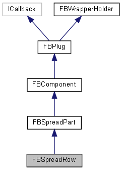

Spreadsheet row. More...
#include <fbcontrols.h>
Public Member Functions | |
