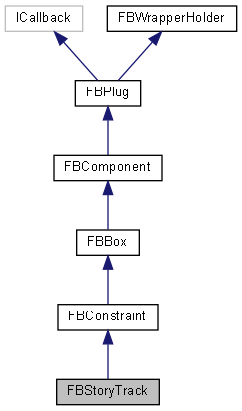

Story Track class.
Tracks are containers for clips (medias), have a specific type which offer different functions. Note: To change the travelling node of a track, search for the "TravellingNode" property on the track and then connect/disconnect the appropriate object. Python example: lPropTravellingNode = lAnimTrack.PropertyList.Find("TravellingNode") lCube.ConnectDst(lPropTravellingNode)
Definition at line 642 of file fbstory.h.
