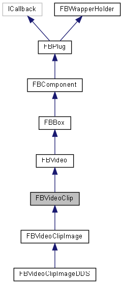

| | FBVideoClip (const char *pName, HIObject pObject=NULL) |
| | Constructor. More...
| virtual void | FBDelete () override |
| | Open Reality deletion function. More...
| bool | IsValid () |
| | Verifies the validity of the FBVideo object. More...
| virtual void | DrawImage (int pX=0, int pY=0, int pW=-1, int pH=-1, int pFrame=-1) |
| | Draw a frame of the image to the current view. More...
| virtual unsigned char * | GetImage (int pFrame=-1) |
| | Get the current image buffer. More...
| virtual void | ImageIncUpdateID () |
| | Increase Image update id after modification to trigger internal state refresh. More...
| virtual unsigned char * | GetPowerOfTwoImage () |
| | Get the current image buffer resized with width and height power of two. More...
| int | GetTextureID () |
| | Get the texture ID. More...
| virtual bool | GetEmbeddedTimecode (int pFrame, FBTimeCode &pTimeCode) |
| | Get the embedded timecode associated to a video clip frame. More...
| | FBVideo (const char *pName, HIObject pObject=NULL) |

Video clip media class.
Definition at line 192 of file fbvideo.h.
